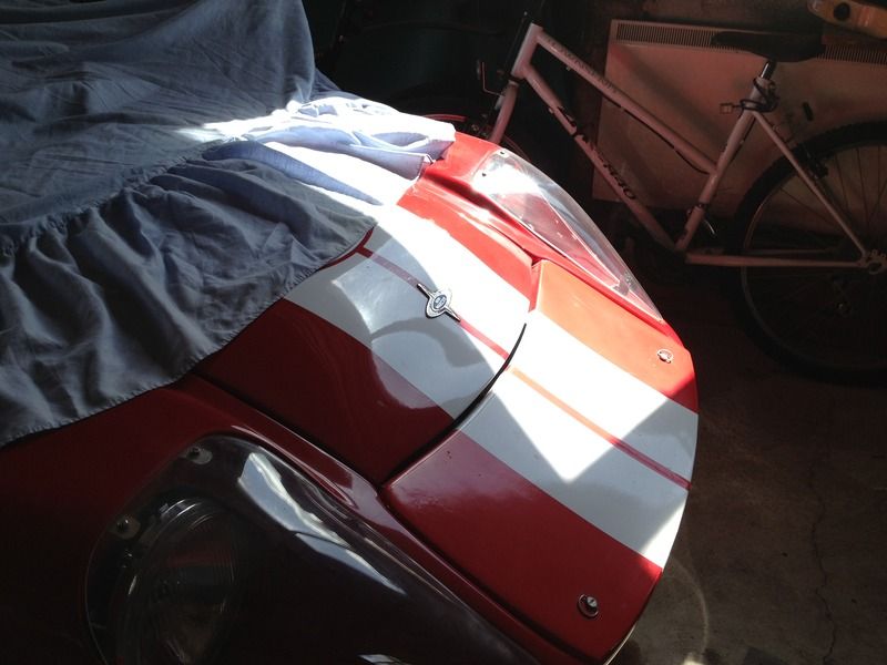

Managed to get the bonnet fitted:
I glued two brackets to the forward edge of the bonnet, then put a sheet of fibreglass over this when it had dried:
I suspect I'll try and do something similar for the front panel.
