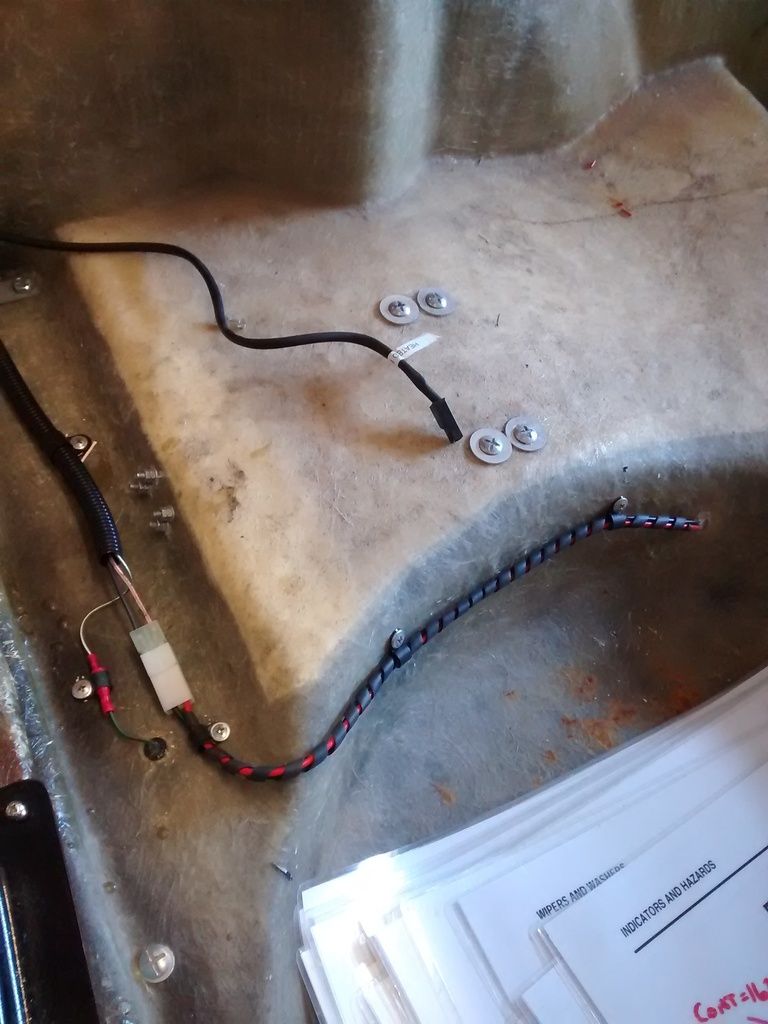

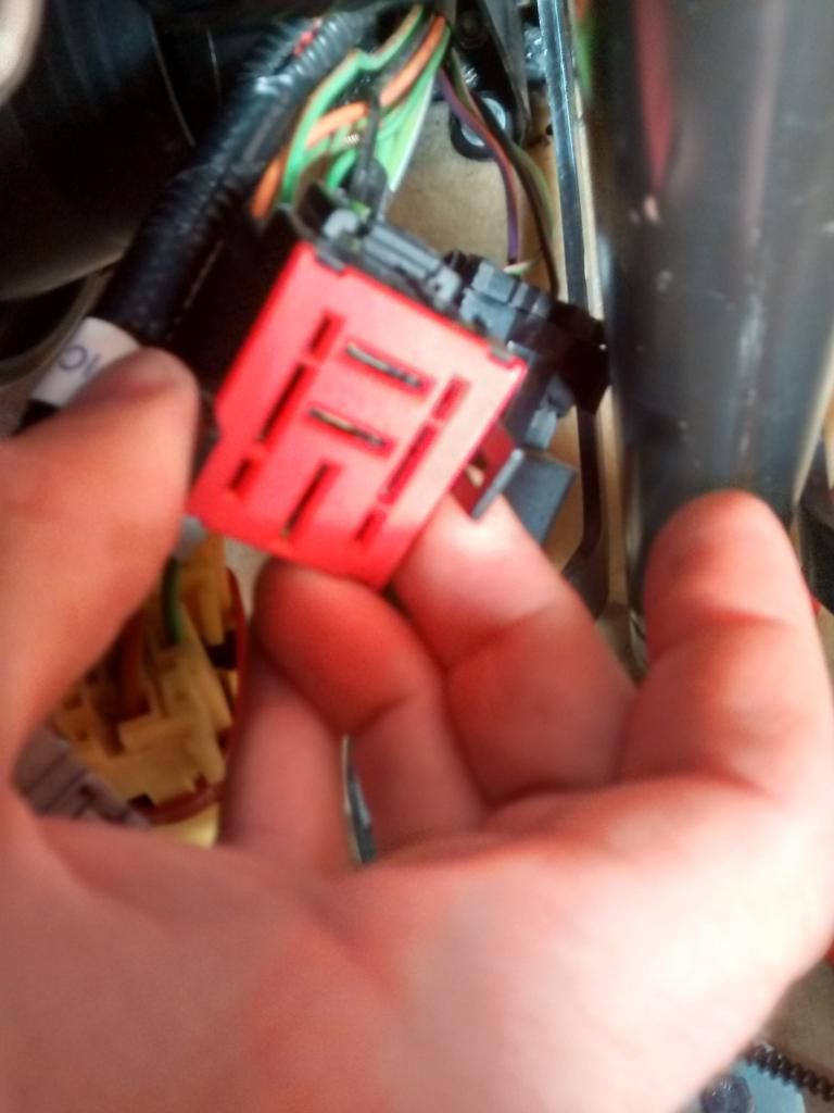

Okay so I've been checking continuity of the wires from the column stalk to the wiper module, and the wiper module to the motor.
I think I've identified a broken wire - one of the green/brown ones between the module and the motor.

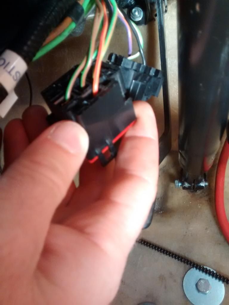

In order to test this theory I need to remove the green/brown wire from the centre of this block:
and run an replacement, external wire to check the high speed function, back into the block:

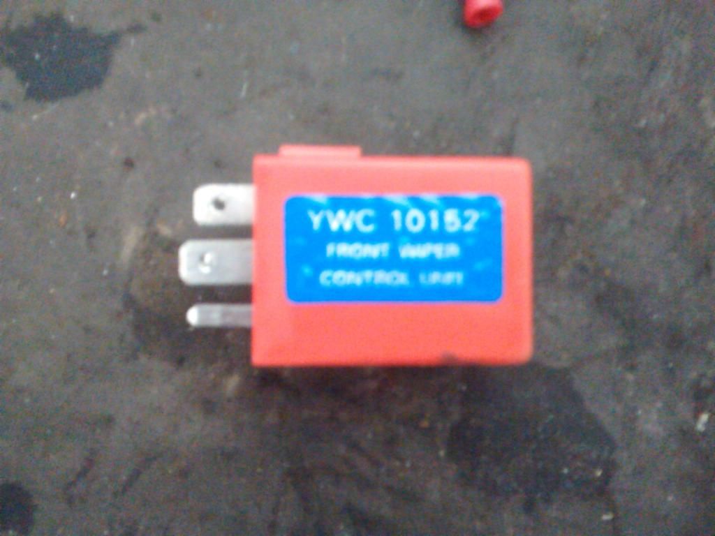

And is there a way to test the wiper module:
I only get continuity across 2 of the five pins.

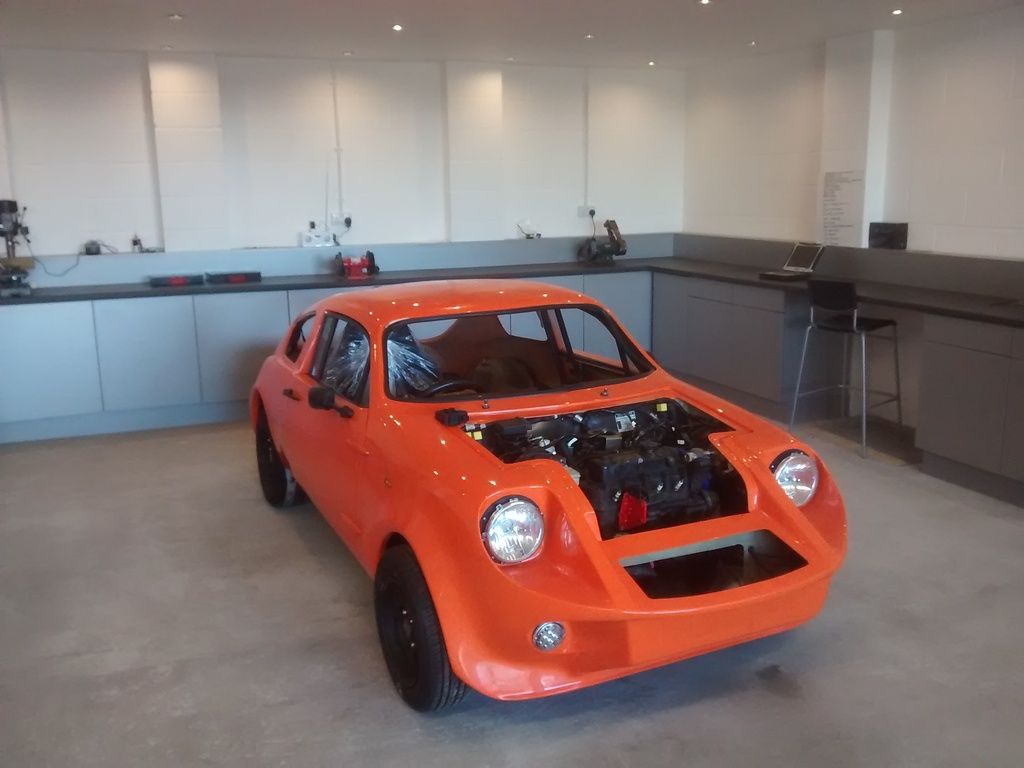

It off getting the electrics done
Went up today to see it, and swap some bits over from the mini to eliminate some part.
The daylight running lights are powered, as are the LED indicators.  But I need a new dash (or printed circuit board at least) and a new wiper motor.  But all lights less the reverse light (no switch to hand) are now up and running.
So possibly by next weekend it'll be back in my garage and I can hopefully start saving up to get the engine parts!

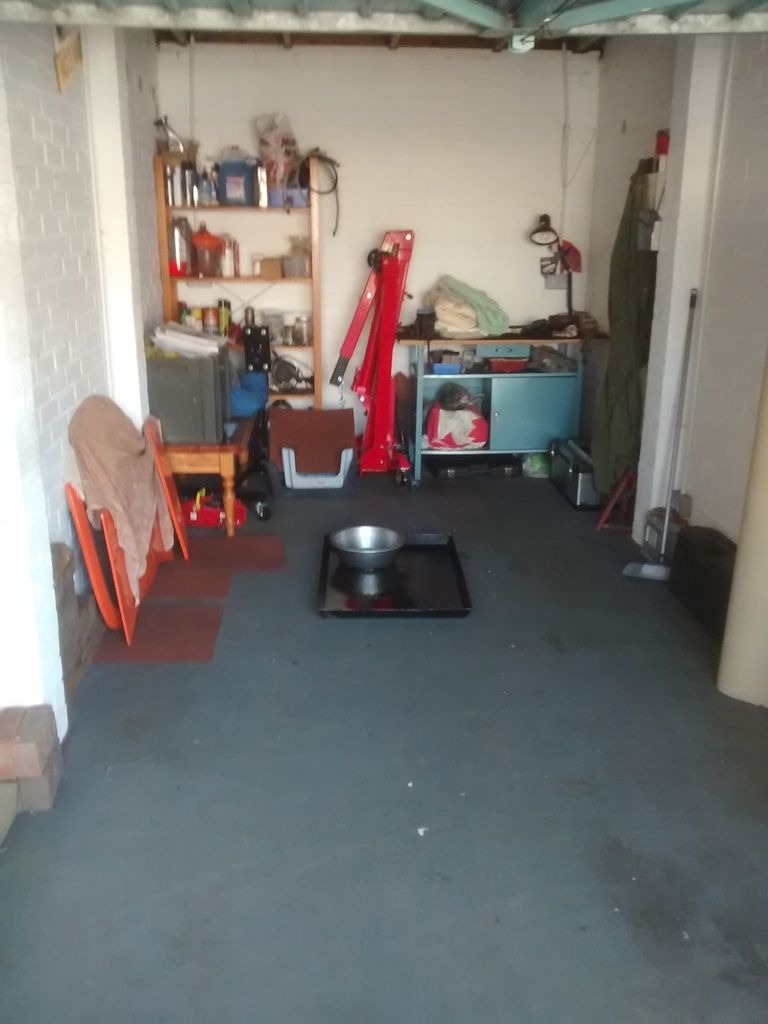

My pal at work who's mechanical engineer has a garage that looks like this.
Looks like he never do anything in it apart from wiping dust
I'm messy, so I won't show you any picture of my garage!

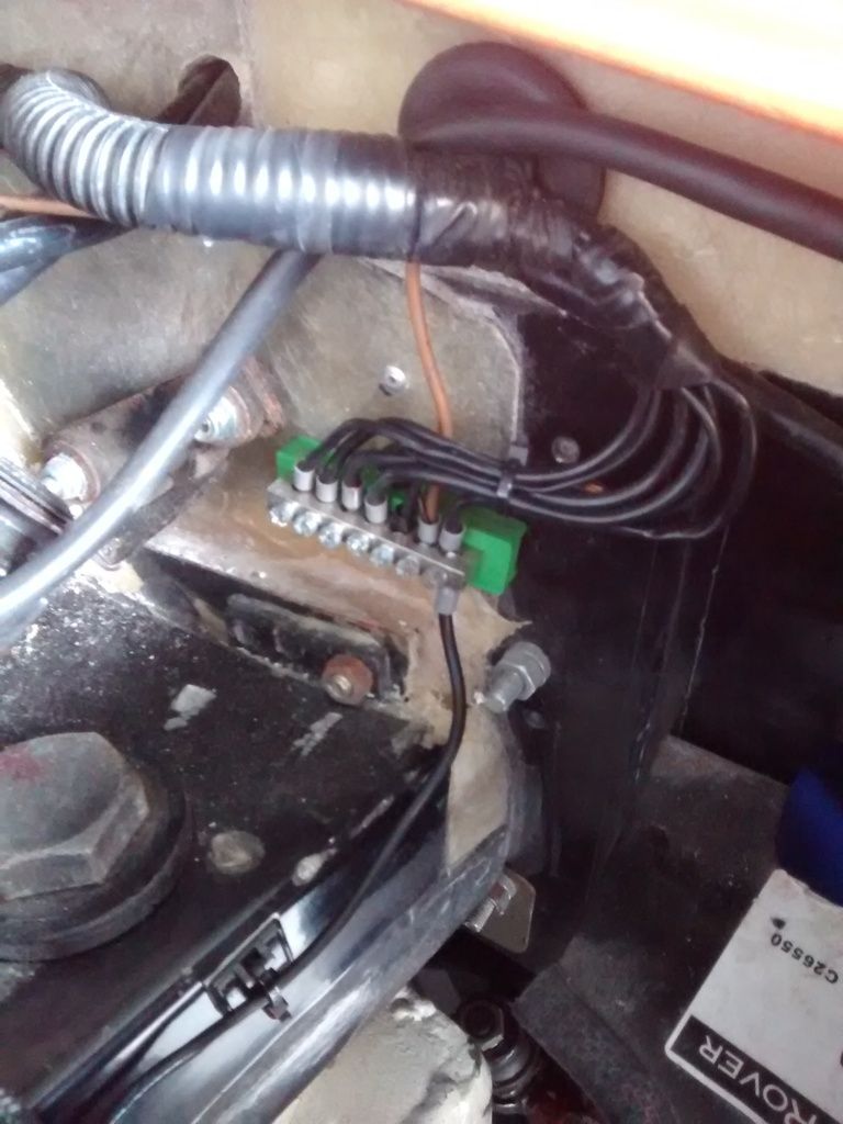

The cars back in the garage now:

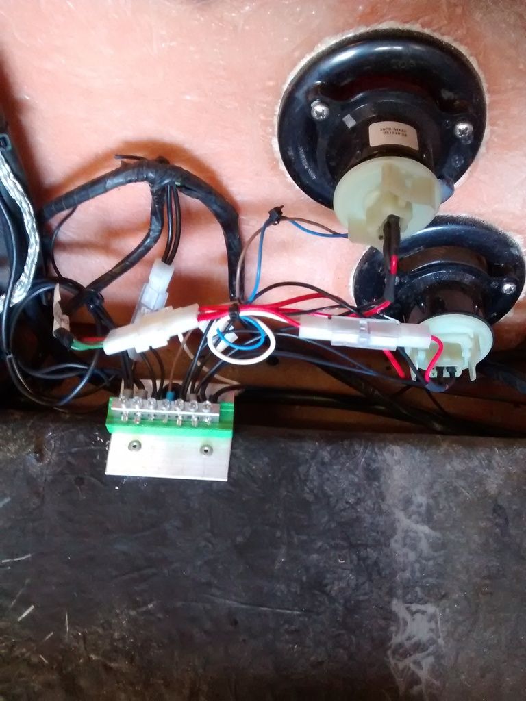

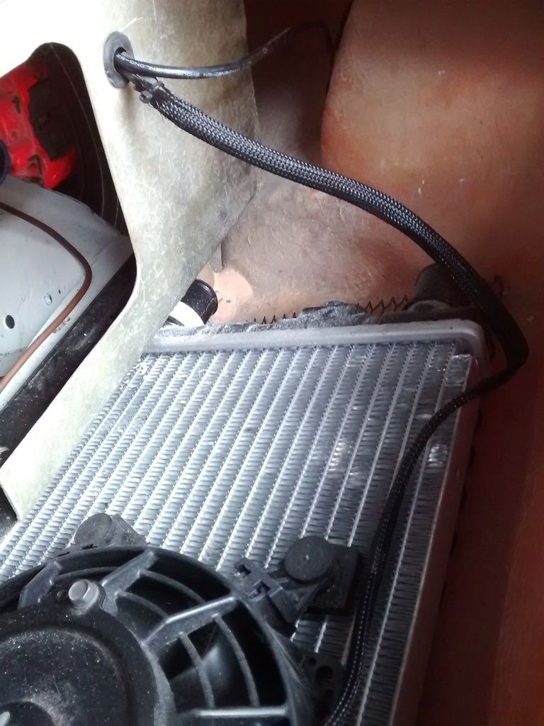

The rear lights - you can just see the heat soak if you look carefully.
He's tidied up the earth's under the bonnet area.
Heavier wire for the fuel pump.
Tidied up from front to rear!
I also gave the old loom that I removed from the car, which donated some connectors and the guy used the rear window heater section to create a 'new' heated front window loom.  These are just a few photo's I quickly took with my phone camera, but I'm really pleased to have the project moving forward again and to have the electrics largely out of the way (to a standard far higher than I'd be able to achieve).
There are still electrics items to be attended to - I need a new wiper motor, a new three clock dash (or at least the printed circuit that attaches to the rear of the clocks - I think you can get them separately) as well as final tidying to be done.  We discussed this and will finish this when the engines rebuilt and in and final cable runs can be decided.

ETA - I also need a new engine relay, which I believe is an item shared with other Rover/Landrover models, so shouldn't be too hard to get my hands on.  It's good having an injection mini to be able ot swap bits over with to test/eliminate bits
