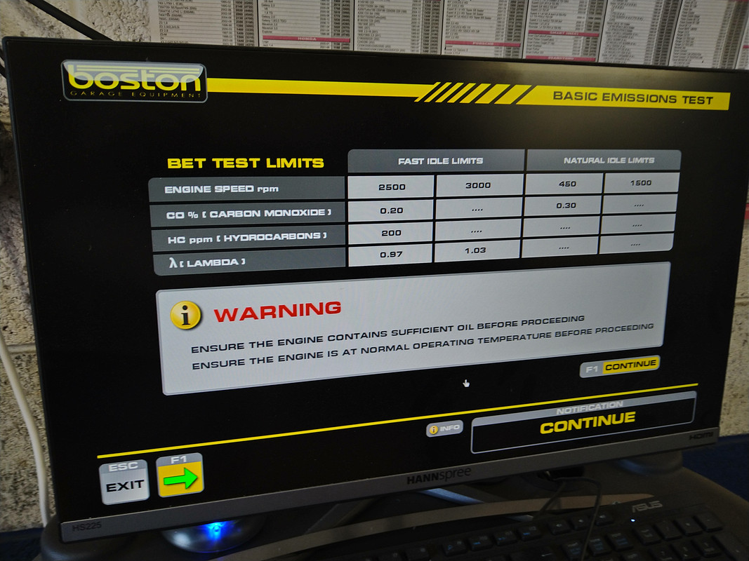

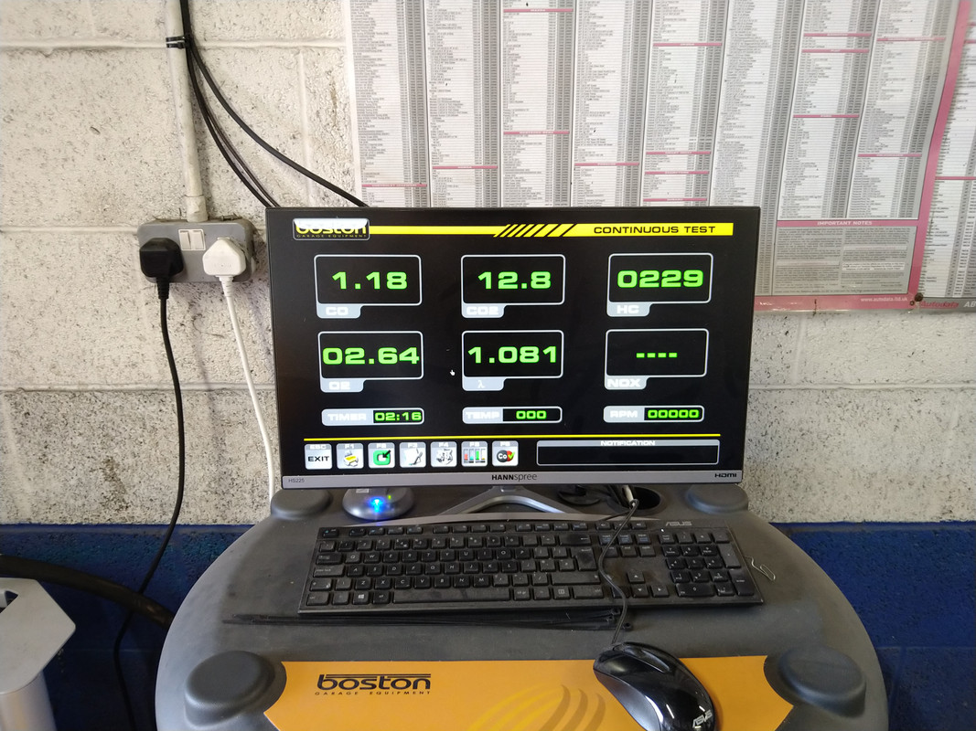

Right, so this afternoon I took the MM around the corner to my local garage who tested the emissions.  This was the readings:
For comparison we pulled up the MoT requirement for emmissions for my old MPi mini:
From this it can be seen that the CO reading is about four times what it should be (it was hovering around 1.3 - the camera caught it at a slightly lower reading of 1.1.
The fact that the car is reading 229 for hydrocarbons and the MoT requirement doesn't show any, I'm, not sure what this is telling me (i.e. is it mean to be zero hydrocarbons, or is it not measured at normal idle?)
So it would seem that I need to have the car mapped to correctly assess what the emissions could be.

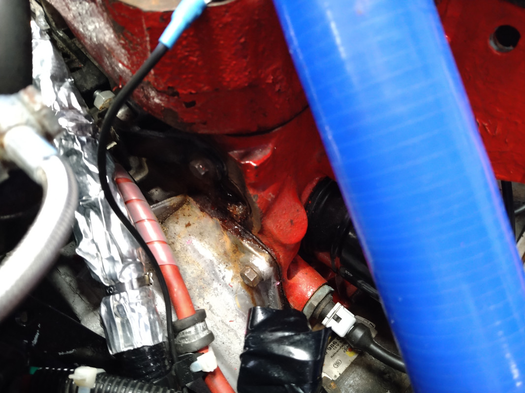

While the car was idling, the guy testing the emission noticed that there was a coolant leak at the core plug at the end of the block, above the clutch cover:
This got me thinking (and worrying):
1. Could this have been as a result of the overheating that occurred during the first IVA test?  What other potential damage could've occurred?
2. When I tried to bed the cam in, I used the rev counter as a guide trying to hold it at around 2500rpm.  I now know the rev counter is far from accurate - i was probably holding the engine at around 4500-5000rpm.  Could this have glazed the bores/would this give the idle hydrocarbon reading?
3. Is it possible to change this core plug with the engine in situ?  I think there would be enough room to carefully knock in a new core plug, but how hard are these to remove?
4. Since changing the ecu/engine loom the car has had a tendency to blow fuse C7 (fuel pump fuse).  I checked the connection to the fuel pump (all tight), connections to the rear loom (seem good), looked at the connections of the new loom (again all look okay).  This habit seemed to stop when I managed to set a steady idle, but it happened again during the emission test.  Pulling the fuse out the fuse box it was hot and the plastic had slightly melted:
(I pulled the metal prongs out)
This has got me worried.  I really don't want the car to catch fire, but am unsure what else to check to find out what this electrical problem could be (would I be right in thinking there is an increase in resistance somewhere in this circuit leading to increased heat?).

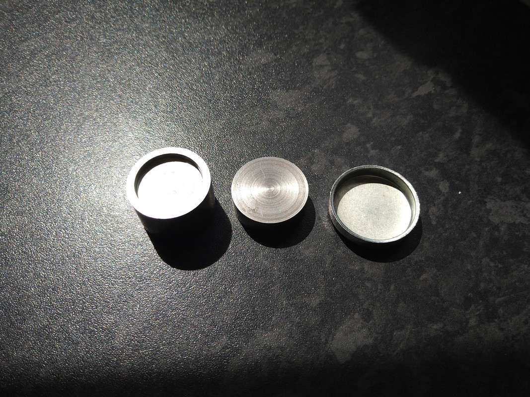

So I had a day off today and decided to fit the core plug.  Given the tight space available (and as I can't justify a hobby lathe!) I googled a local machine shop and had a couple of dolly's made up as it wasn't possible to easily fit in a socket to hit.
The company made these up for me while I waited - I was expecting to see a length of bar faced off in an old Colchester but they actually did this in a CNC milling machine in front of me.
CNC was just coming in to common use when I did my apprenticeship some 35 years ago (and wasn't something I've ever done) but it was fascinating to see.
I ended up asking for two thicknesses of dolly - 10mm thick and 20mm.  I also asked for a lip to be machined into one side.
These allowed me to fit the core plug this afternoon.
I used instant gasket around the circumference of the plug/hole, but can see from the photograph that the plug isn't quite square - is this going to cause me problems?  Am I going to have to refit this (I do have a second core plug if needed)?
