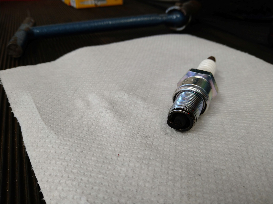

I've just pulled the spark plugs - wet and smell of petrol. They wiped/brushed easily and look like new (they aren't very old to be fair). I've checked the gap too, and put them back in for now. Mike - I'll give the blow torch idea a go but I don't have a car to hook up the jump lead to at the minute and didn't fancy leaving the plugs out. I should be able to give the car another try on Friday. Thinking about it, there's obviously fuel getting through. The car was trying to start, so there must be a spark of some kind (can check that it's all four cylinders on Friday). The only thing thats changed is the lambda. Hmm... |

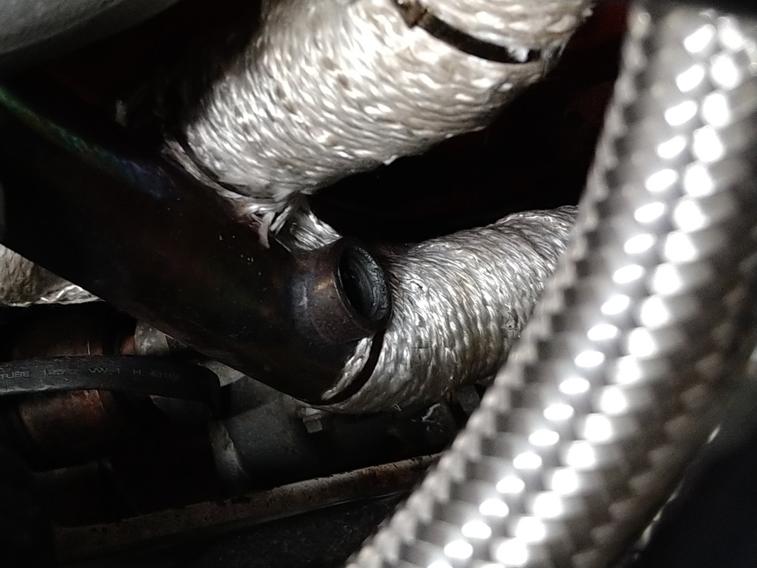

Craig - I 'think' I understand what you're trying to say. If viewed from the bulkhead looking forward, the lambda is mounted in the exhaust between 2 and 3-ish:
 Another viewpoint with the lambda removed:

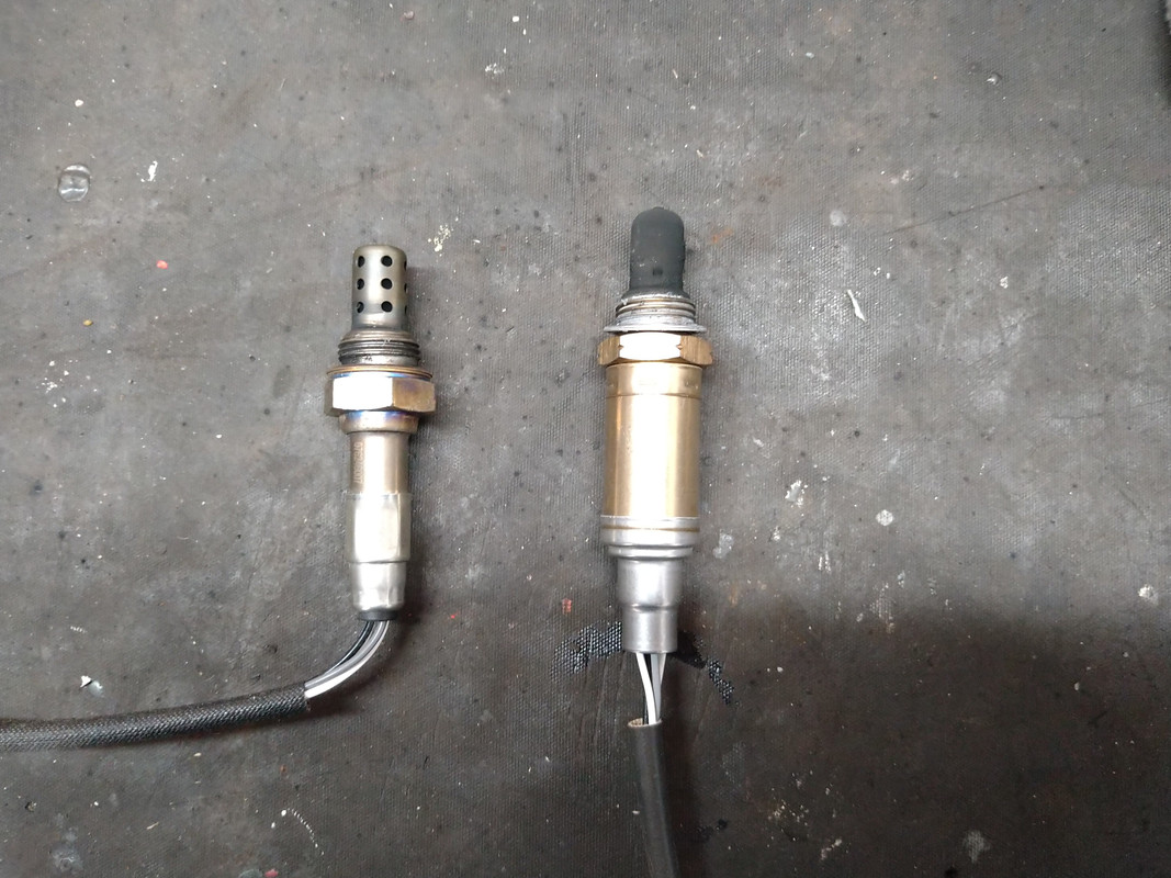

So why is the lambda removed? I decided to start at 'ground zero', so decided to reinstate the original lambda sensor:

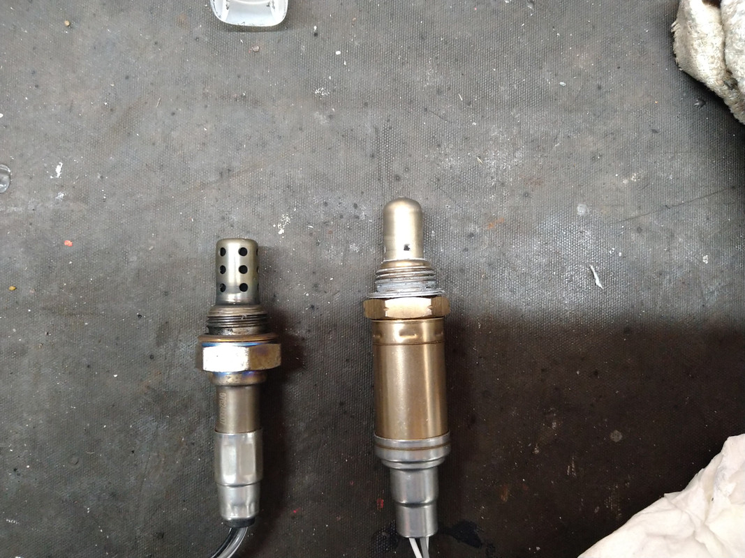

 The original (albeit wiped clean) is on the left. The replacement unit is on the right (as removed from the car). Wiping the 'new' unit clean it looks like this:
 While they don't look exactly the same, the replacement unit was supplied by Huddersfield Spares and advertised as a direct replacement part for the MPI injection mini.

ETA - And it appears to be blowing exhaust gas from the cylinder head, or possibly from the lambda sensor (if the sealing washer isn't sealing any longer). |

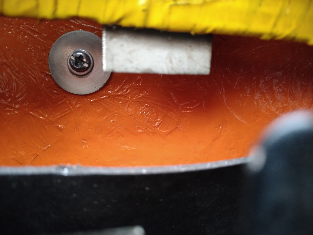

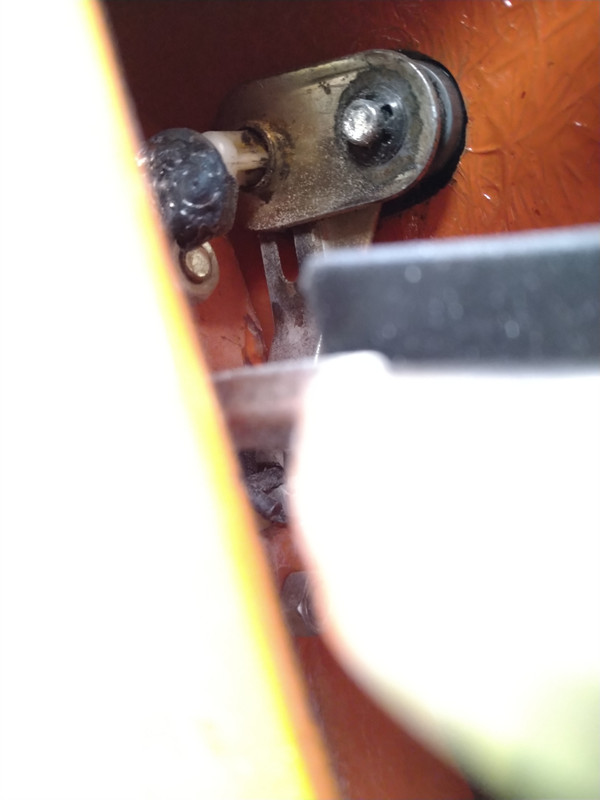

Took off the inner door trim this morning to look at the passenger side exterior door handle which is now loose. From what I can see within the door, and consulting the Minispares 'Classic Mini Parts Manual' blue book, I can't determine what holds the door handle firmly in place (I didn't build the doors up - they were already in place when I bought the shell. The forward end of the handle has a screw fixing (this end of the handle is secure on the door):
 Its the other end of the door handle that is loose i.e. the part nearest the rear of the car which has the handle button. What holds this in place?

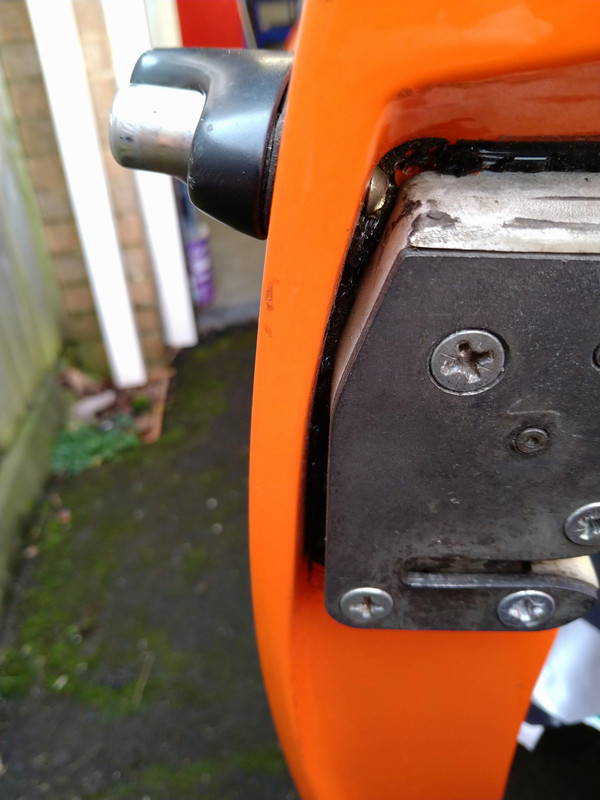

After looking at the drivers door and finding the same set up, I released the forward retaining screw on the passenger side. This allowed enough movement to realise that the rear most retaining screw wasn't inside the door, but outside, above the retaining latch (brass coloured screw in this photo):
 No wonder I couldn't feel anything when fiddling around inside the door! Removing the screw showed that the thread on it was good, therefore the thread in the handle is the problem. For now I've bodged a cut down wood screw, to allow the handle to be safely used to open and close the door. But I realise this handle needs to be changed. The hardest part was repositioning the latch which needed to be loosened to remove the existing screw. When the doors were built up, washers were used as packing. These of course, fell out. Getting these back in, in the correct location, in the correct quantities was a nightmare - I've managed to scratch the paint (gelcoat?) on the B-pillar/door jamb with the door latch. Bugger! But we got there in the end, with the door latching correctly (two stages) and I suspect now with better clearance than before. I started the car up again - still coughing and spluttering, but with it warmed a bit and idling, think I've managed to identify which connection is leaking fuel. I now need to let the exhaust manifold get cold and look to address that. Slowly making progress. |

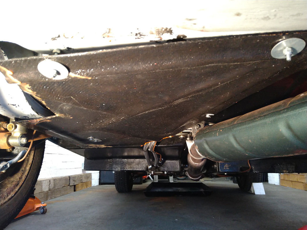

So with no sign of the fuel leak reoccurring at the fuel tank, I took the opportunity this morning to refit the underbody panel:
 I could describe this as a carbon fibre rear diffuser panel, but more accurately it's a (carbon fibre) panel I made up to try and keep the dirt off the underside and the fuel pump/filter assembly.

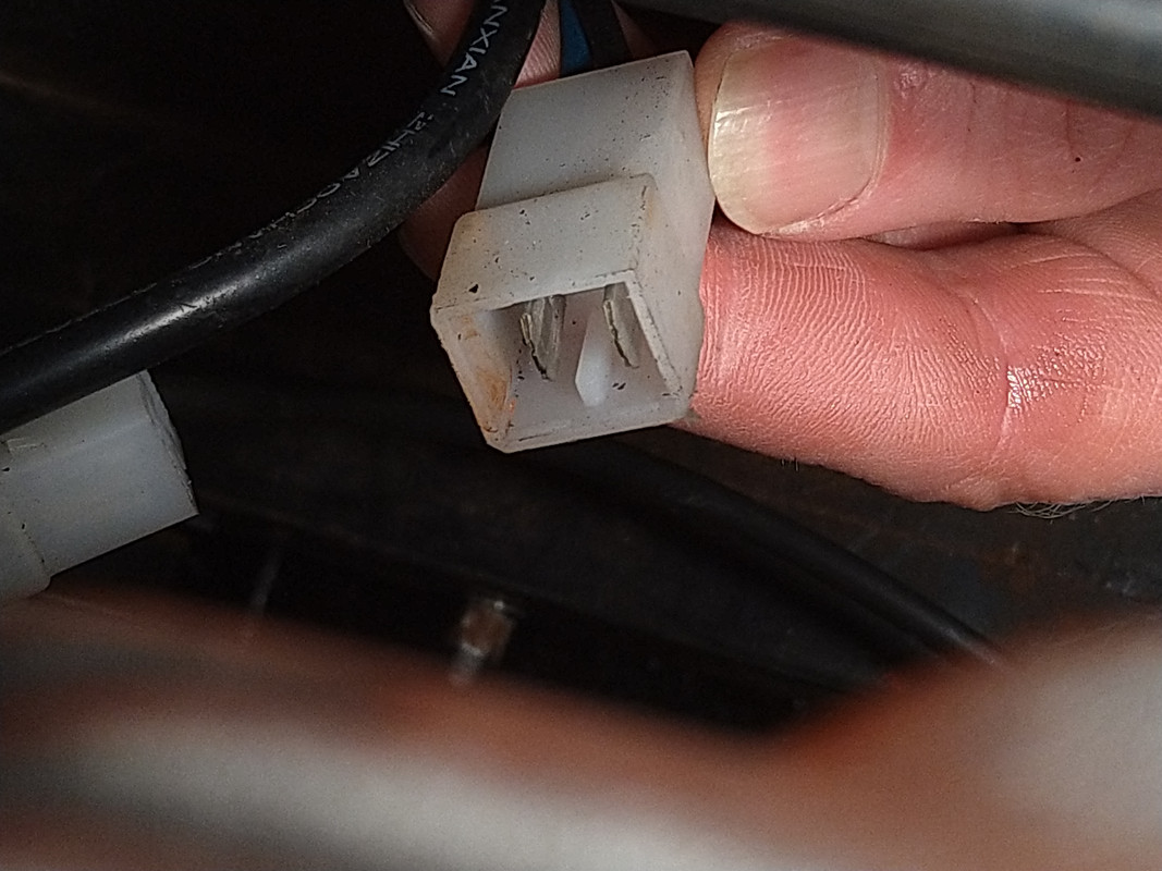

Does anyone recognise what type of electrical connector this is?
 A bit of a long shot, but this is the male end connector as fitted to the radiator fan. If possible I'll like to retain the female (loom) end, so would like to get hold of another (male) end to use on any replacement fan/fans. As an aside, I woke up this weekend thinking 'I've got another fan in the garage'. Weird! But I did - unfortunately it's too big to fit (I think I might have bought this many years ago to fit onto my MPI mini). But I'm trying to progress things - the throttle and speedo cables are on order, hopefully back with me in a week or so. So hopefully a Happy New Year for me as well as you all .
ETA Sods law - think I've found it. https://www.carbuilder.com/uk/multipin-wiring-connectors-2-way-pack-of-5 Does that look right? |
